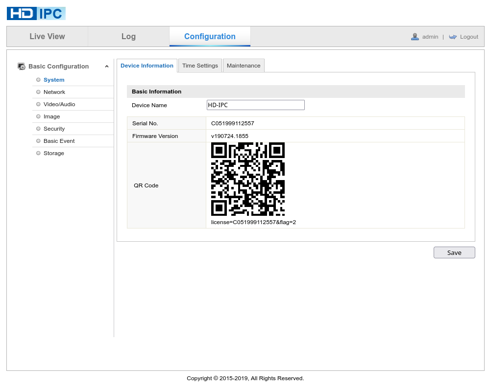

I few weeks ago I bought a second-hand DS-2CD2020F-I and configured it to upload images via FTP to my local server, ready as a spare. I got it out again this morning as I wanted to connect to it via Windows in a VM (I've been a Linux user for the past 15 years) so that I could configure the motion trigger area map, which was the one thing I couldn't do before. For some reason, upon power up it had changed it's mac-address, static IP, and annoyingly, lost the menu item to access the Advanced settings for FTP etc. It seems to have gained access to WiFi settings, which I didn't see before.
A factory reset has made no difference.
I guess the firmware is old, but I don't want to update it and not be able to go back, if there is some hidden way of resolving this.

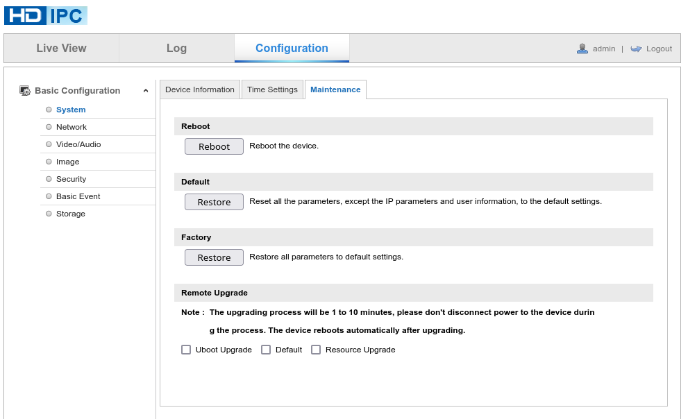

How do I put it in TFTP mode? The only maintenance options are:

Off topic but looking at that screenshot, I think that is the oldest firmware I've ever seen on a Hikvision camera!

As I now know that firmware is region specific, and I am in Thailand, and I only have what the dealer that sold the unit said as model number, I firstly need to correctly identify the region and actual product model from the serial number/firmware version - is that possible?
If it is a DS-2CD2020F-I, how to know which firmware to download, as that model doesn't appear in the list?

All attempts to 'factory reset' the cam result in it having an IP address of 192.168.1.203, even when it is connected (through a 5 port switch) only to my notebook with network set to 192.0.0.128, according to tcpdump. It has a button on a trailing cable that I assume is a reset button - it squwarks when held in. I tried holding that button until it squwarks, remove power for 30 seconds, then apply power and wait for the click, before releasing the button. 192.168.1.203 asking where is 192.168.1.1
The fact that it also changed the MAC address and removed the ability to apply firmware updates looks suspiciously like a malicious attack to me - is it soldering iron time, or is there another way to make it truly reset?
