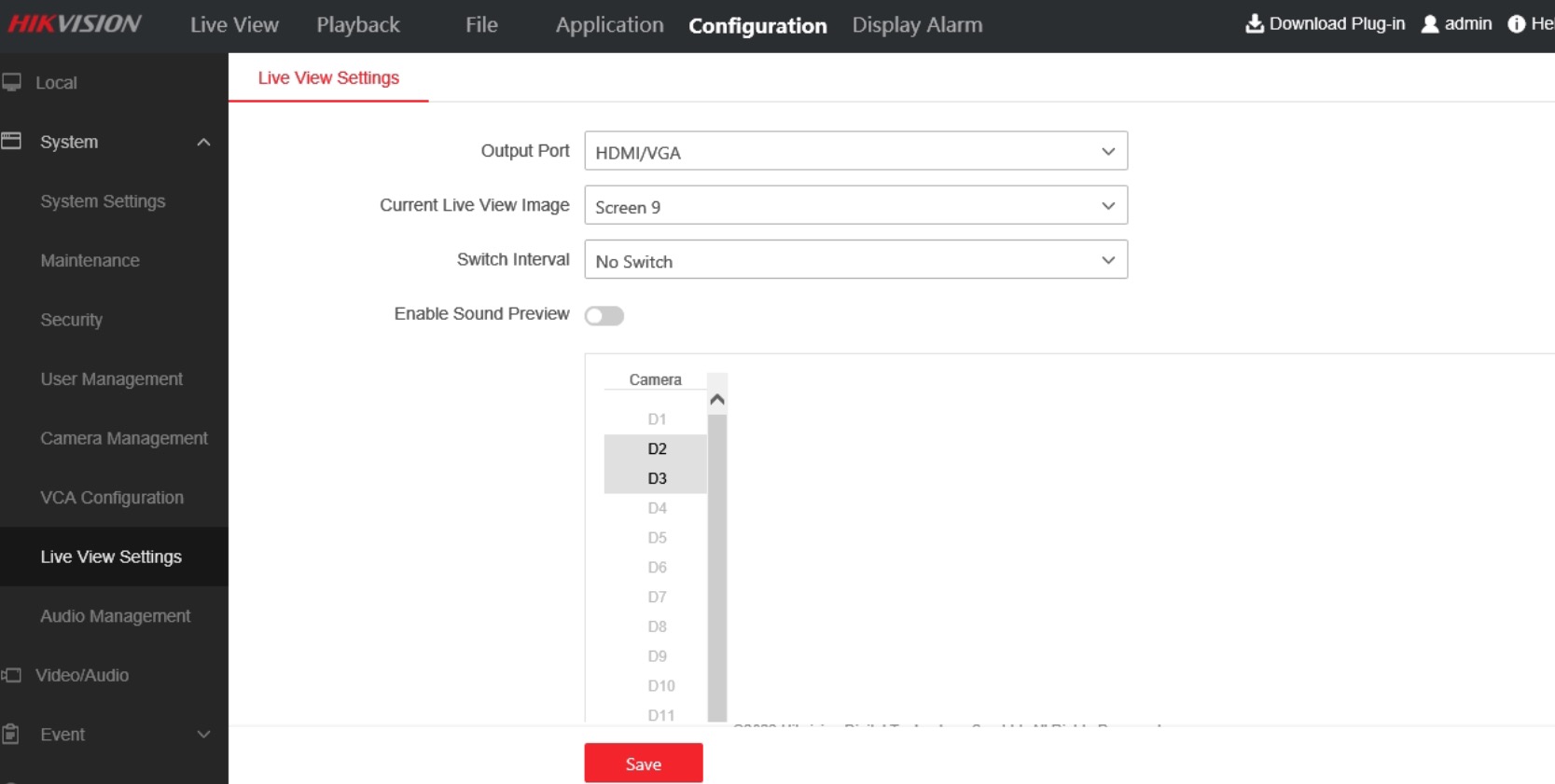

Installed the new firmware on the NVR
V4.61.067 build 220928
Suddenly, can no longer set the LIVE View Settings for the HDMI outputs.
What a joke, now I need to drive to the client site.
