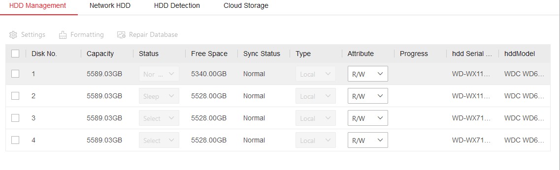

Good morning all,
I've been trying to work out why my Drives just fill and not R/W or Overwrite once all are filled. I think the settings on the Series M are correct?
I had to reformat in the middle of the night to stop the bleeping so the photo shows free space.
Am I missing something or maybe the disks are missing a jumper>?
Any help appreciated.
Thanks
John

Good morning all,
Thanks
John

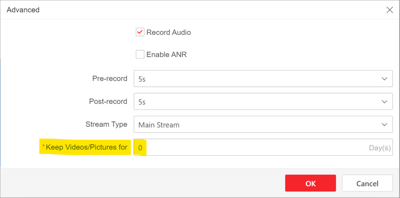

Hi @John A
You'll need to set the "Keep Videos/Pictures for" field in your Advanced Recording Schedule settings to "0" for the NVR to overwrite the oldest footage when the hard drives fill up:
It's worth running the S.M.A.R.T and Bad Sector Detection hard drive tests in Storage>Schedule Settings>Advanced in a web browser to verify if these are the problem.
