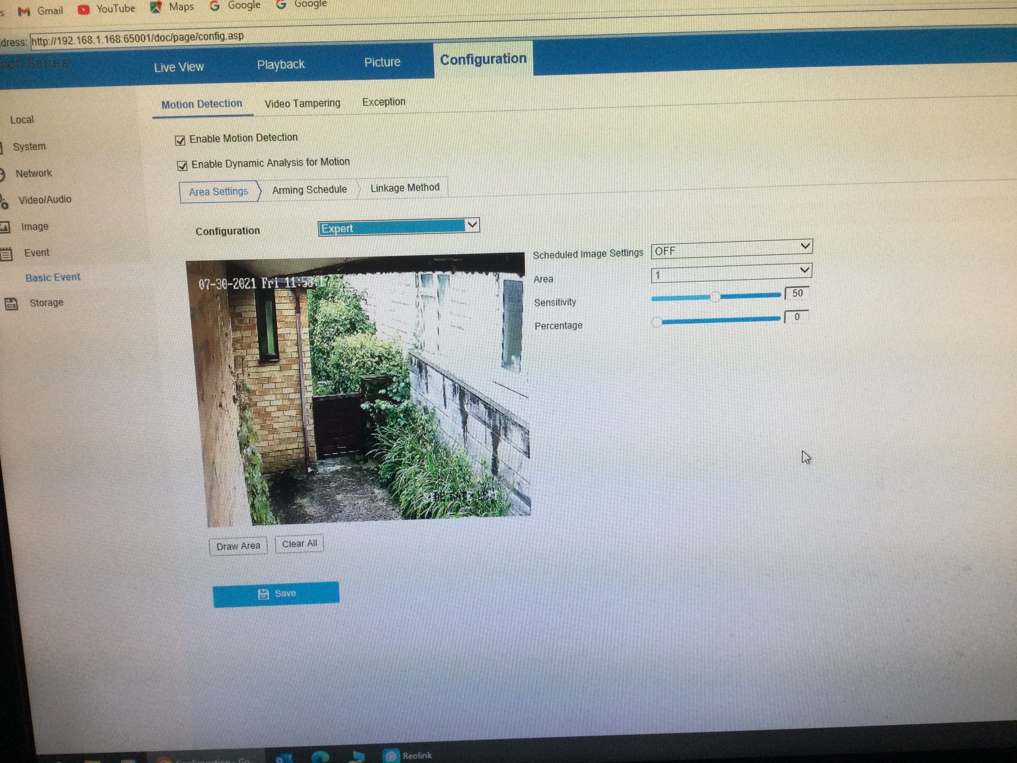

Trying to set up the motion detection settings on my x2 hiwatch cameras
can anyone tell me what these settings do on the configuration menu
thank you

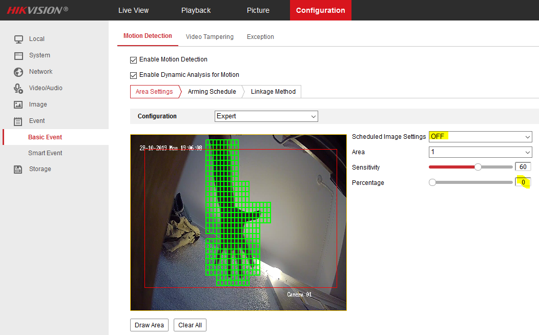

Hi @warrendanielsmith
They're explained nicely in this post:
Be careful with the percentage setting.
Sensitivity: Range [1-100]. The value of the sensitivity defines the size of the
object which can trigger the alarm. When the sensitivity is high, a very small
object can trigger the alarm.
Percentage: Range [1-100]. Percentage defines the ratio of the in-region part of
the object which can trigger the alarm. For example, if the percentage is set as
50%, when the object enters the region and occupies half of the whole region, the
alarm is triggered.
I suggest lowering the percentage to 0% for testing, you can always fine-tune later.
Scheduled settings at OFF should trigger 24/7 (mine does).
