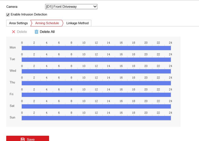

Ok at a bit of a loss here, this has been working perfect for a while, now it isn't.
Basic checks
1) Email account? Sent test email to all 3 users in group. Works ok.
2) Check intrusion detection

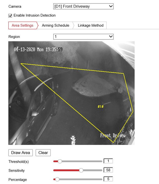

Area Settings
Area 1 is Yellow
Settings
58
5
Arming Schedule all Blue

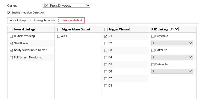

Linkage method
Send Email
Trigger Channel D1
I have also checked in Event logs nothing showing here when i jump around like a loonie in the zone of camera D1, any ideas here? Im loathed to do a full factory reset but i don't know what else. Help appreciated!

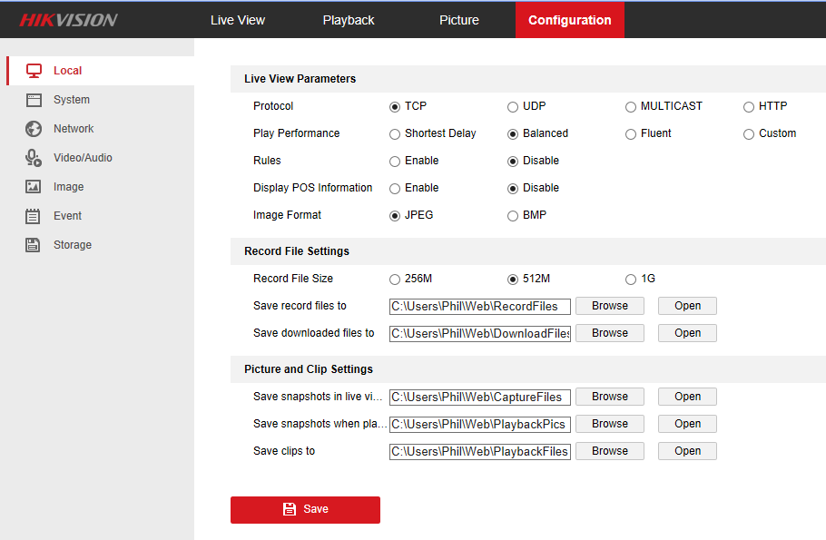

Enable "Rules" and you should be able to see if you are triggering motion detection.
As your logs show nothing, then probably not.
Thanks for your input here. Enabled rules and retried rebooted device even, no difference and nothing in logs.

Enabling Rules just lets you see/verify that detection is working.
You should see a box around/highlighting detected events.

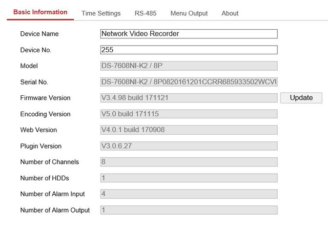

I can see from the last screenshot that your NVR is not running the latest firmware so I would suggest updating to the latest v4.21.005 firmware and see if the problem persists.

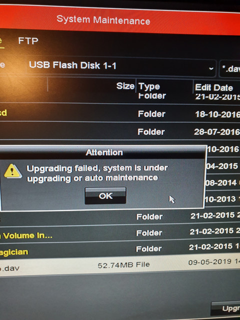

Ok tried to upgrade direct and this occurred

Still not sure about the above though seen that before? Thanks for your help here all the same.

Thanks for the update, it is not a message we have seen before. We have seen problems before where upgrading through too many firmware versions in one go doesn't work so maybe try updating to the last v3.4.xxx firmware before upgrading to the v4 firmware.
The last firmware version before the v4 firmware was v3.4.104
