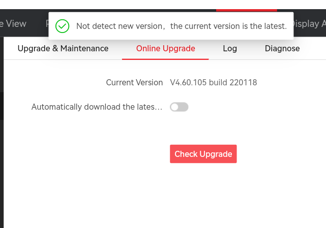

Did you Update Online? Because every time I search for a new update it says you are using latest version!
Sorry to confirm that the online check has never worked yet - it always tells you that you are on the latest! :(
