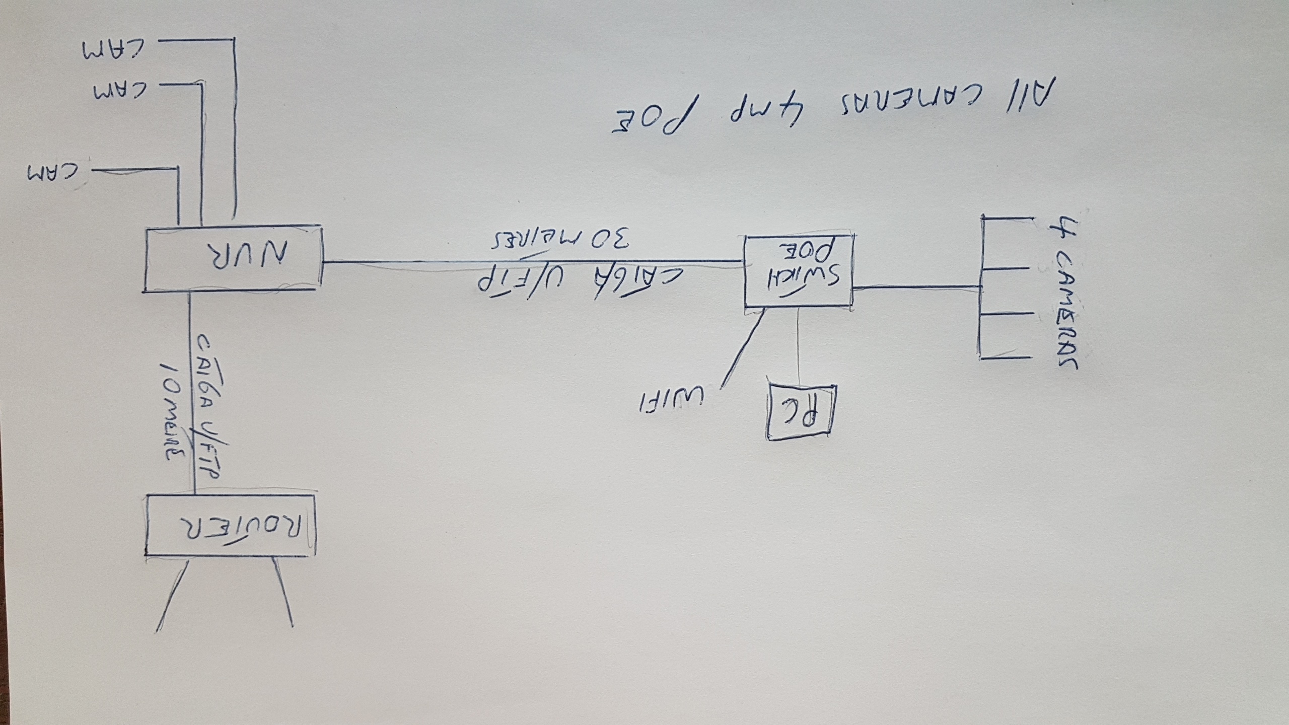

Hi,
I would much appreciate a once-over of my scheme. I’m not too clued up as yet.
I hope the attached sketch gets the point across. I am planning a network for CCTV and have decided on hard-wired as wireless looks like a nightmare to manage. My router is located in a separate room from the planned location of the PVR/UPS, at about 10 metres distance. My workshop is located at 30metres distance.
My question, is it possible to incorporate 4 POE cameras as well as internet access all over one Cat6a U/FTP cable? If this is possible, what would be the best switch. Managed/unmanaged?
Is my layout the best for this scheme?
The entire CCTV system will be POE, and I really favour the Hikvision kit. More on that after I have finished with the wiring.
I need remote access to all cameras.
Observations/suggestions much appreciated.
